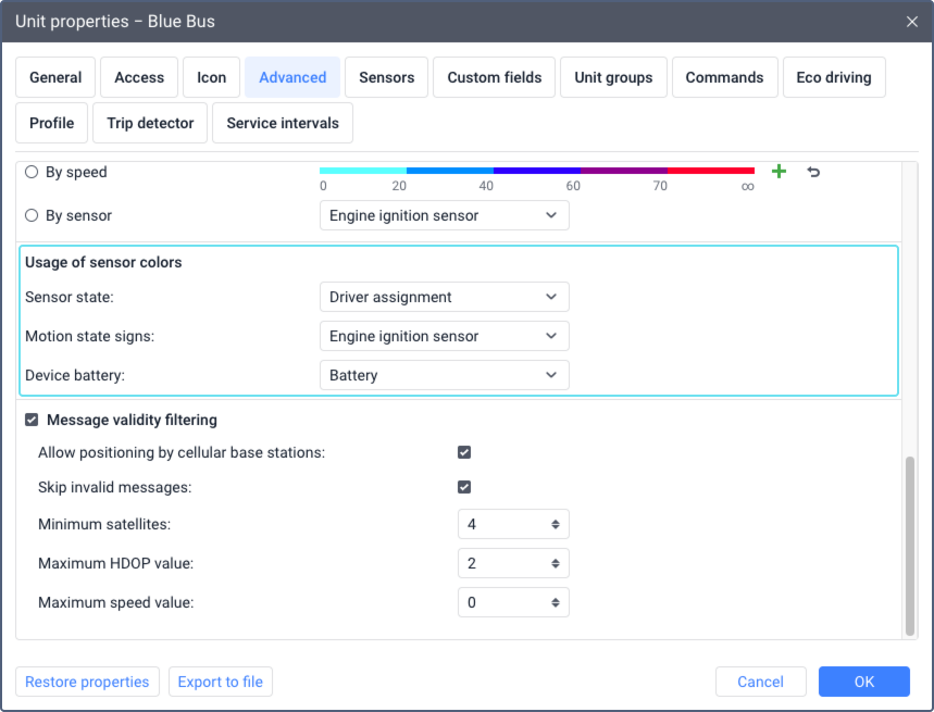

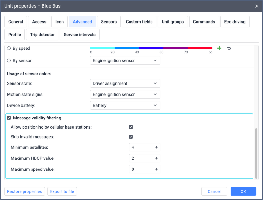

The Advanced tab consists of several sections. In these sections, you can configure parameters for reports, track and sensor colors, filtering of unit messages, etc.

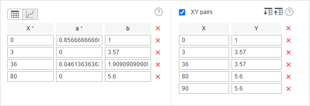

How to determine fuel consumption, if I know how much fuel the unit consumes within the city, and how much outside it?
Let us suppose that the fuel consumption in the urban cycle is 10 l/100 km and 7 l/100 km — in the suburban cycle.
  • Create an ignition sensor (as in the example above) and set 1 l/h for the consumption during idling.
  • The average consumption in the urban cycle is 36 km/h, in the suburban — 80 km/h.
  • The unit will cover a distance of 100 km driving at a speed of 36 km/h in 2.8 hours. 10 l / 2.8 = 3.57. Let us calculate the value of the increasing coefficient when moving in the city: 3.57 / 1 (idling) = 3.57.
  • As a result of a similar calculation for the suburban cycle, we obtain the coefficient equal to 5.6.
  • Create an engine efficiency sensor, taking into account the fact that the unit cannot consume less fuel than during the idling, and that it is stationary before the beginning of the movement. As a parameter we use the average speed (speed + # speed) / const2 and fill in the calculation table (manually or using the calculation table wizard):
Note that the last pair of points is how the system calculated before (the fuel consumption was considered constant for a speed above 80 km/h). You cannot use this method and change the set of points. Also ‘3’ in this example is the minimum speed from the unit’s trip detector, consequently, this parameter can be different for your unit.
Result: in our example, the average consumption has been calculated for the unit. It has been calculated relative to the speed and time between messages and taking into account the values of the vehicle operation.

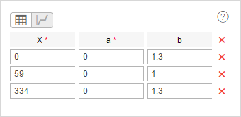

How is the seasonal coefficient calculated?
As a rule, the seasonal coefficient supposes increased fuel consumption. For instance, the consumption in winter is 30% higher than in summer. Let us suppose, that the winter in your climate is from December, 1 to March, 1.
  1. Create an engine efficiency sensor with the parameter time:d.
  2. Find out which numbers of the day in the year do your dates correspond to. High precision is not obligatory: a year may be a leap one and the season itself may be longer or shorter. For the period indicated above, for example, the numbers are ‘334’ and ‘59’ approximately.
  3. Create a calculation table as seen in the screenshot below.
time is the parameter that is present in any message from any device, and the system will calculate the number of the day automatically on its basis. In that way, as the season starts, 30% will automatically be added to the fuel consumption.

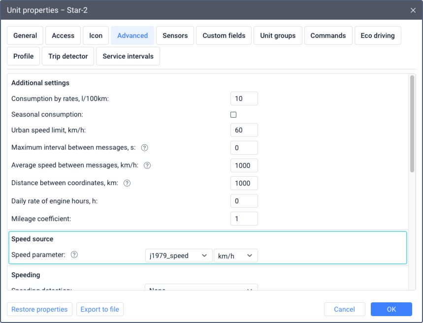

Speed source
This section is shown for certain device types for which changing the speed source is supported in the monitoring system.
In most cases, the monitoring system uses the values calculated by the device via GPS as speed values. They are stored in the unit messages in the speed parameter. If they are not correct, you can specify the parameter the values of which should be used for the speed parameter.
To set the speed source correctly, follow the steps below.
  1. In the Speed parameter field, select or specify the name of the parameter (no more than 50 characters) the values of which should be used as speed values. The list shows all the parameters sent by the device, except for the virtual ones.
  2. Select the unit of measurement in which the device sends speed values (not the unit of measurement which should be shown in the monitoring system). If the unit of measurement is not selected, the system uses km/h.
  3. Save the changes.
After that, the speed value is taken from the specified parameter.
After that, the speed parameter values from the unit messages begin to be replaced by the values of the specified parameter in all parts of the system without the possibility of recovery. If the messages don’t contain the specified parameters, the usual values of the speed parameter are used.

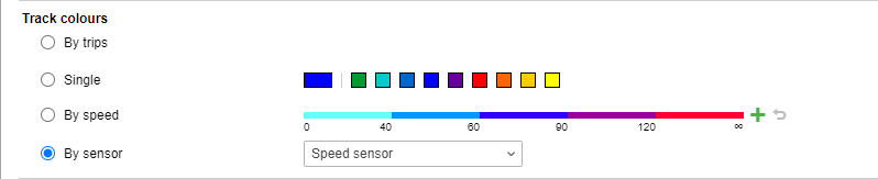

Track colors
In this section, you can set the color for tracks, that is, the lines of unit movement on the map. The tracks are mapped on the Tracks, Messages, Reports, and Monitoring tabs (the Quick track option).
Tracks can be single- or multi-colored depending on the settings according to which the color is determined. You can select one of the four options:
  • by trips;
  • single;
  • by speed;
  • by sensor.
ItemDescription
By trips
The track is divided into sections of different colors, each of which corresponds to one trip. Trips are detected by the trip detector.
Single
The track is single-colored. This option is useful when mapping tracks for unit groups because they don't merge with each other in this way. You can select a color from the palette.
If you map several tracks in a row, the next color from the palette is used for each track.
By speed
The track is multi-colored depending on the unit speed. To add an interval, click on the icon , specify the speed values ​​and the color for the interval, and click OK. An empty value in the first field is considered as -∞, in the second as + ∞. You can select the color from the palette or specify it in the HEX format in the field above.
The created intervals are shown on the line scale. To edit an interval, click on it, make changes, and click OK.
To reset the settings to the default ones, click on the icon  to the right of the scale.
By sensor
The track is multi-colored depending on the values of the selected sensor. The list contains the sensors created for the unit. The value intervals and colors for tracks are specified in the sensor properties.
If the interval settings have been deleted from the properties of the selected sensor, the system will automatically switch to another sensor that has the intervals configured. In case there are no other sensors with configured intervals, the system will use the By trips option.
Usage of sensor colors
In this section, you can select the sensors the colors of which should be used for certain interface elements. A sensor is available for selection after you create it and specify its value intervals  and the colors corresponding to them.
Below are the interface elements for which the colors of the selected sensors are used.
ItemDescription
Sensor state
The colors of the selected sensor are used for the Sensor state option in the work list on the Monitoring tab and in the menu of monitoring options on the map.
Motion state signs
The colors of the selected sensor are used for motion state signs on the map.
Device battery
The colors of the selected sensor are used for the Device battery option in the work list on the Monitoring tab and in the menu of monitoring options on the map.
Also, the sensor selected here is used on the Health check tab for the Device battery level criterion.
To configure a sensor which shows the device battery level, you should create a custom sensor with the parameter in which data on the battery is received from the device. If the data is received in volts, and not in per cent, then you should also fill in the calculation table in the sensor properties so that the data is displayed correctly.
If the unit doesn’t have suitable sensors, these options are inactive.
Message validity filtering
All messages from units are registered in the database. However, some messages can be invalid, for example, due to data fluctuations or lack of coordinates. Such messages distort the values of mileage, tracks, indicators in reports, etc.
In order for the system not to take invalid messages into account, enable the Message validity filtering option and configure the required criteria: the number of satellites, unit speed, or the accuracy of coordinates. Here you can also enable the options for determining the location by LBS and filtering the messages identified as invalid by the device itself.
Regardless of the settings in this section, any messages with zero or no coordinates are filtered automatically. A message is considered invalid if at least one coordinate (longitude or latitude) is equal to zero.
Filtering is applied only to GPS data, so if an invalid message contains other parameters, for example, sensor values, they can still be used in the system.
The settings in the section apply only to the messages received after the settings have been adjusted.
OptionDescription
Allow positioning by cellular base stations
This option works for devices which support positioning by cellular stations. To see a list of such devices, select the required section on the Hardware tab and apply the LBS filter.
The option allows using cellular base stations (LBS) to determine the unit location, for example, when GPS data is not valid. The data obtained this way is not as accurate as GPS data and shows only an approximate location.
LBS data is used in the following cases:
  • when the Allow positioning by cellular base stations option is enabled and there are no messages with GPS data for more than five minutes;
  • when the Allow positioning by cellular base stations option is enabled and the messages with GPS data received over the last five minutes don't meet the specified filtering criteria.
During these five minutes, the system shows the unit location and motion state determined by the last valid GPS data. The LBS messages received in the meantime don't affect the displayed unit location and motion state, but you can see these messages in reports and in the table of messages.
After five minutes, if the values of all LBS parameters (mnc, mcc, lac, cell_id) remain the same as in the last message with valid GPS coordinates, these coordinates continue to be regarded as the last known unit location and the motion state icon doesn't change. As soon as new values of the LBS parameters are received, a new unit location is shown according to them, and the motion state icon changes to .
If the unit location is determined by LBS, the speed values are not taken into account in the system. In this case, the unit tooltip, the extended unit information and the Speed column in messages show 0.
Messages with LBS data are not taken into account in the trip detector and eco driving.
Skip invalid messages
The option allows ignoring the GPS data identified by the device as invalid. Some devices (controllers) send special parameters which identify invalid coordinates. Also, the current time and the last valid coordinates are specified in the message. The system considers such a message to be without positional data and doesn't use it for mapping tracks, determining the location, and so on.
Minimum satellites
In this field, you can specify the minimum number of satellites that should be used to determine the coordinates in order for the message to be considered valid. The recommended number is at least four. The value can't exceed 255.
Maximum HDOP value
In this field, you can specify the maximum HDOP value with which messages are considered valid. HDOP stands for horizontal dilution of precision. The smaller this value is, the more accurate the coordinates are. The value can't exceed 9,999.
Maximum speed value
In this field, you can specify the limit for speed values. If it is exceeded, the message is considered invalid. You can't indicate a value greater than 9,999. If 0 is specified, this filtering criterion is not taken into account.
If the speed or HDOP value exceeds the maximum allowed one, or the number of satellites is lower than the specified one, the following data of the message becomes unavailable: speed, coordinates, number of satellites, and altitude.
