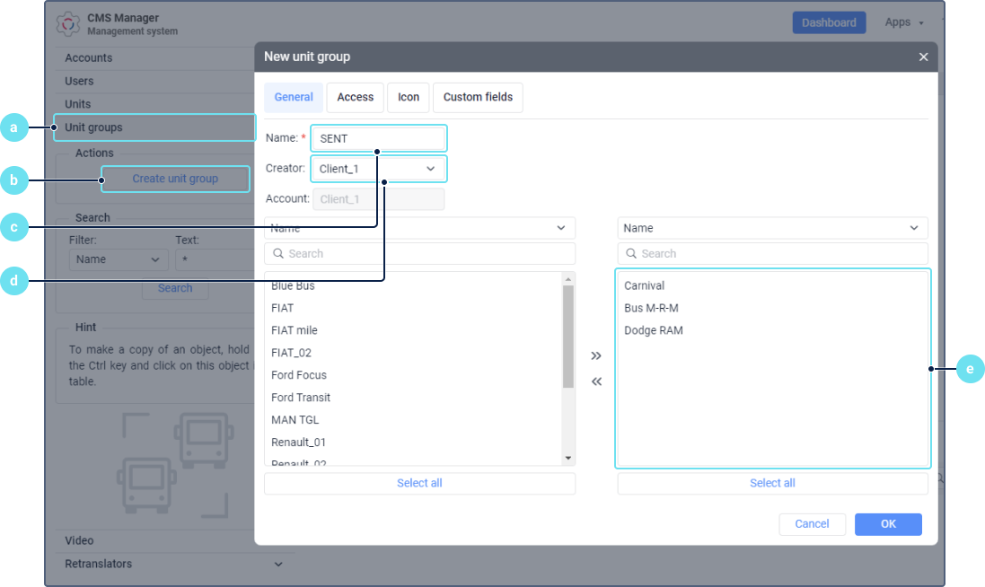

Step 3: Creating a unit group
In the carrier account, create a group with the required units. To do this, do the following:
Open the Unit groups tab in the management system,
Click on Create unit group,
Enter a name for the group,
Specify the carrier as its creator,
Add the required units to the group.

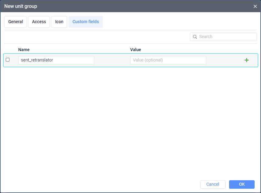

Step 4: Creating a custom field
On the Custom fields tab of the group properties, create a custom field named sent_retranslator. Do not mark this custom field as administrative and do not specify its value. Click OK.
