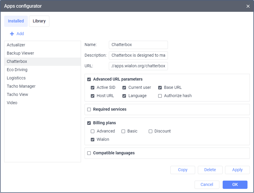

Installed
The list of added apps is displayed on the Installed tab. To add a new application, click Add and indicate the information described below.
Name
Enter the name of the application (at least 4 characters). It is displayed in the lists of available applications, as well as in the heading of the application when it is open.
Description
Enter any description of your app (optional).
URL
Type the URL where the application is hosted. Name and URL are mandatory, other parameters are optional.
Advanced URL parameters
If necessary, select advanced URL parameters. It is required to enable the Active SID or Authorize hash option so that users can log in to the application.
Advanced parameter
Description
Active SID
Enable this option to configure authorization by SID. With this authorization type, the user is not logged out of the application after a page refresh.
Current user
Enable this option, so that the URL contains the username that was used to log in to the application. It might be helpful, if the user logs in to Wialon using the Log in as button.
Base URL
This option doesn't affect the configuration of applications in Wialon Hosting.
Host URL
Language
Enable this option if you want the application interface to be in the same language that is selected in the user settings in Wialon.
Authorize hash
Enable this option to configure authorization by hash. With this authorization type, the user is logged out of the application automatically after a page refresh.
Example of a URL with all the advanced parameters:

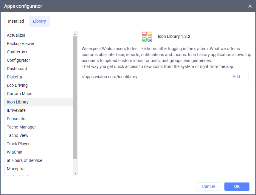

Library
On the Library tab, you can select a suitable application and add it with a single mouse click. Adding an application from the library is a little bit easier because all the mandatory parameters and the advanced URL parameters are indicated by default.
The list of applications is on the left. To the right of the list is a field that displays the current information for the application selected in the list. This information includes the following: application icon, its name, short description, URL, and release date. To add an application from the library, you must select it from the list. Then, if this application is not already installed, the Add button is activated below the description. To complete the procedure click Apply and then OK.
