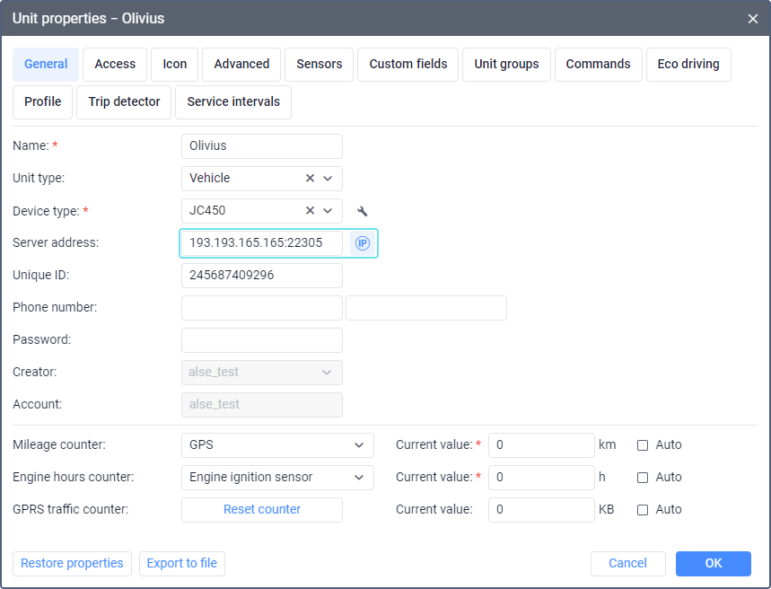

  1. Send the command BCD,1# to configure the device ID type. In response to the command, the device reports the last 12 digits of its IMEI.
    By default, the command BCD,0# is used. In response, the device reports the last 14 digits of its IMEI in HEX. Additional conversion to DEC is required in this case.
  2. Use the command SERVER,Server_adress,22305,NA,NA,NA,NA to set the server address. You can find the server address and port in the units properties.
  3. Send the command APN,APN_name,APN_value to add and set the APN of the SIM card.
  4. Use the command REBOOT to reboot the device.

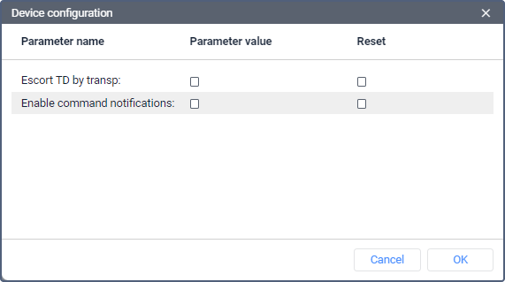

Additional device settings are available in the unit properties upon clicking on the icon  next to the Device type field.
The available settings are as follows:
SettingDescription
Escort TD by transp
Enable this option if you want to receive data from Escort TD additional equipment.
Enable command notifications
Enable if you want to receive command responses in a pop-up window.

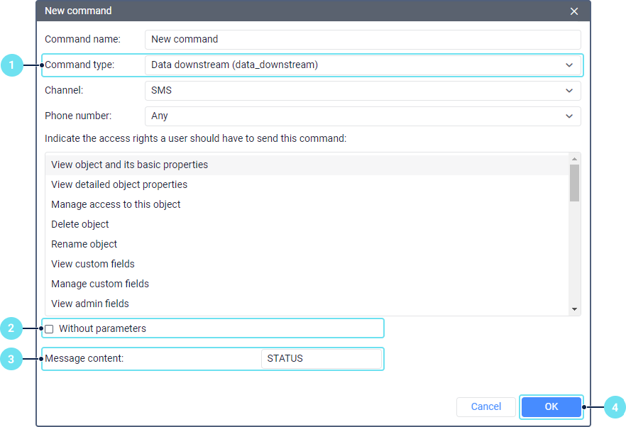

After the device is connected to Wialon, you can use commands to change certain settings in the device configuration. To configure a command, follow the steps below.
  1. Create a command of the Data downstream (data_downstream) type.
  2. Disable the Without parameters option.
  3. Type the command text in the Message content field. For example, to receive the device status, type the text STATUS. To obtain the full list of available commands and their texts, contact the device manufacturer.
  4. Save the created command.
