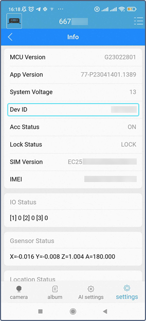

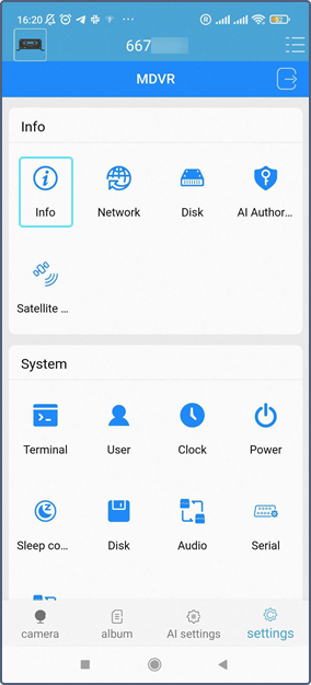

  4. Open the settings and select the Info item.
    You can find the device ID in the Dev ID line.

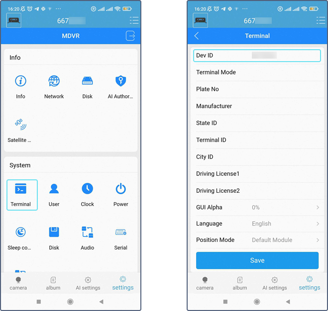

    If you need to change the ID, select the Terminal item of the System section in the settings. Change the ID in the Dev ID field and click Save.

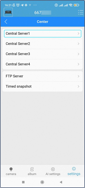

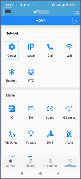

  5. In the settings, select the Center item of the Network section.
  6. Select the server.

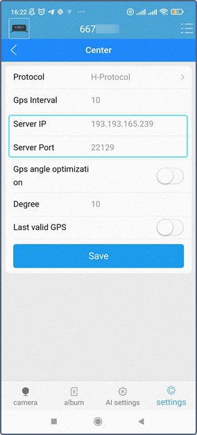

  7. Select H-protocol in the Protocol list. Click Save.

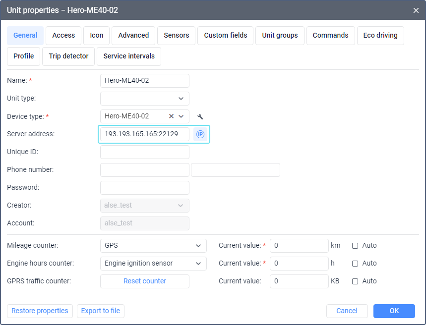

  8. Specify the server IP and port 22129. Click Save.
    You can find the IP address and port in the unit properties.

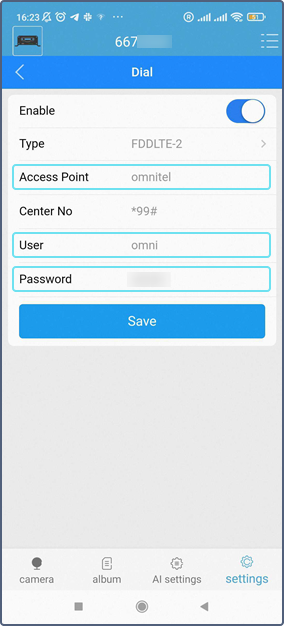

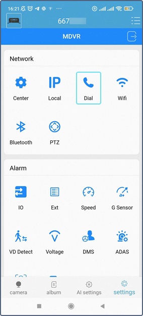

  9. In the settings, select the Dial item of the Network section.
  10. Specify the APN settings: fill in the Access point, User, Password fields according to the instructions of your mobile operator. Click Save.

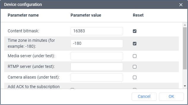

The additional device settings are available in the unit properties upon clicking on the icon  next to the  Device type field.
The available settings are as follows:
Setting Description
Content bitmask Here you can specify a bitmask which determines the parameters that should be sent by the device. To send all the available parameters, enter the value 16383. Content bitmask values are described below.
Time zone in minutes Here you can specify the time zone of the device in minutes. For example, for UTC+3 enter 180, and for UTC-5 enter -300. The time zone affects the playback of videos and the registration of messages.
Add ACK to the subscription request This option allows adding the ACK packet which acknowledges receiving a message. Use only if the device has the ACK option activated.
Speed from CAN This option allows replacing speed values by the CAN parameter.
0x4040 Subscription upload model This option allows setting data upload priority. Use 0 for real time priority, 1 for history priority, 2 for mixed.
The Media server (under test)RTMP server (under test)  and  Camera aliases (under test)  fields are deprecated. They should be left blank.

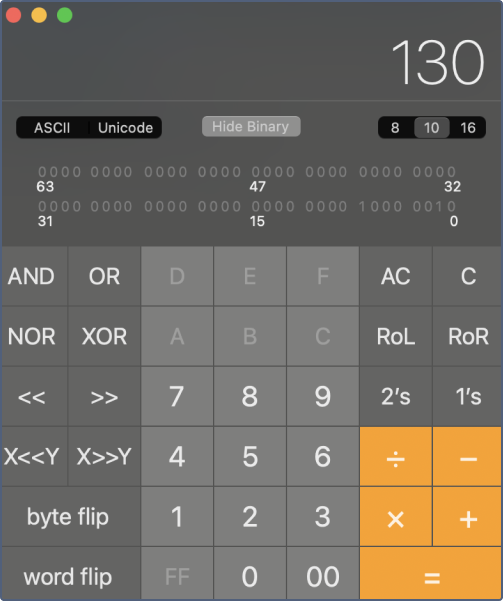

To find out the bitmask value, you should convert the bits into decimal values.
For example, if you need data from bits 1 and 7, enter the value 130 in the Content bitmask  field.
