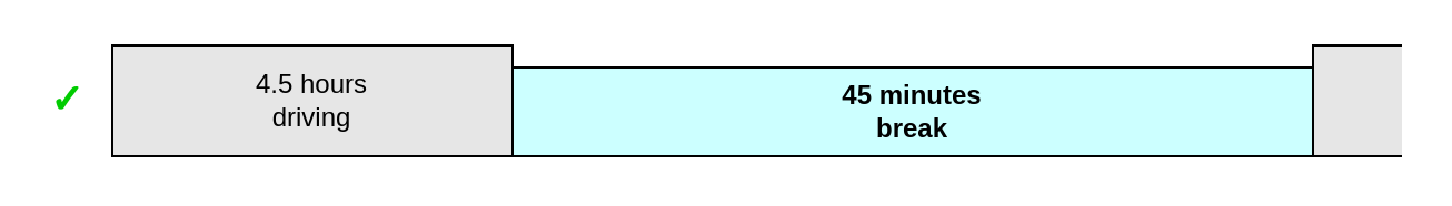

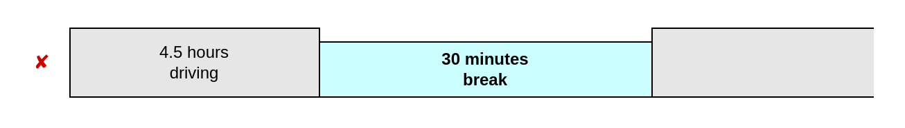

  • You can drive a maximum of 4.5 hours without stopping for a break. After that, a break of 45 minutes should be taken.
    Examples
    Example 1. The driver drove for 4.5 hours and then took a break for 45 minutes. In this case, there are no violations.
    Example 2. The driver drove for 4.5 hours and then took a break for 30 minutes. This is a violation, as the duration of the break is not enough.

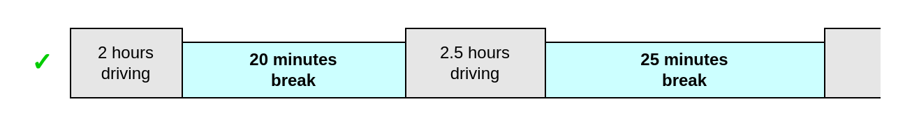

  • If within 4.5 hours of driving you take a break of more than 15 minutes but less than 45 minutes, then at the end of the 4.5-hour driving period, you can take a break of such duration that in total with the previous break will be equal to 45 minutes. If the break lasts less than 15 minutes, it will not be counted.
    Examples
    Example 1. The driver drove for 2 hours, took a break for 20 minutes, then drove for another 2.5 hours and took a break for 25 minutes. In this case, there are no violations, since in total there were 45 minutes of rest for the 4.5-hour driving period.

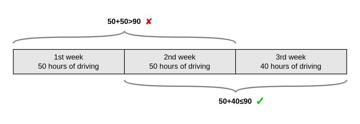

  • The maximum driving time within one working week is 56 hours, and within two consecutive weeks — 90 hours.
    Examples
    Example 1. The driving time in the first week was 50 hours, in the second — 40 hours, and in the third — again 50 hours. In this case, there are no violations, since in each individual week the limit of 56 hours was not exceeded, and in total for each two consecutive weeks the limit of 90 hours was met.
    Example 2. The driving time in the first week was 50 hours, in the second — 50 hours, and in the third — 40 hours. In this case, there is a violation: despite the fact that in each individual week the limit of 56 hours was not exceeded, in total, the limit of 90 hours for the first and second weeks was exceeded.

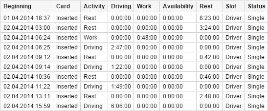

Reports on drivers
The Driver activity table shows DWH information.
The Infringements table shows the information on the DWH violations.
In the settings of both tables, a file from the driver card, online data or assignments and trips can be selected as the source of information.

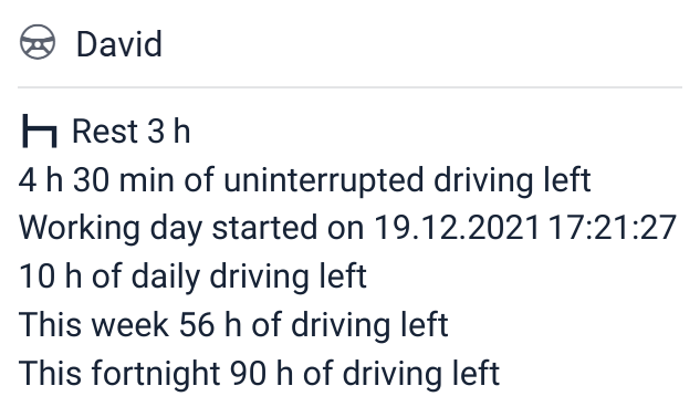

To use this method, you should first enable the Driver activity by online data option in the general user settings.
When hovering over a driver, the information on DWH and violations will be displayed in a tooltip.
The same information will be displayed in the unit tooltip and extended unit information, if the display of drivers in the mentioned places is selected in the user settings and the driver is assigned to this unit.
The source of information for this way of displaying is always online data.
