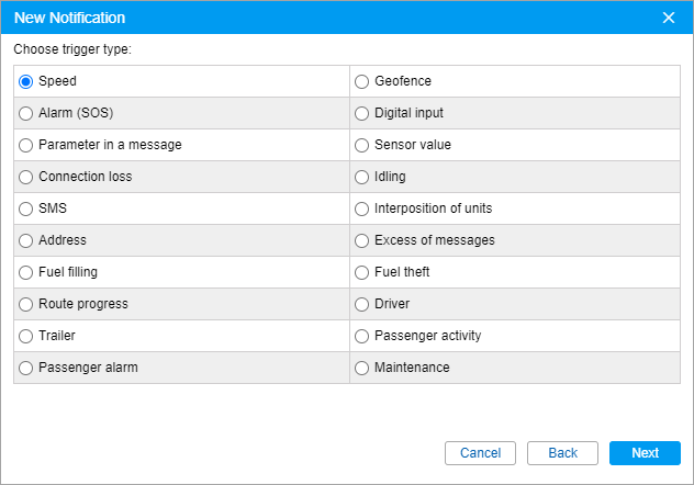

Notification Types
There are different conditions for triggering notifications.

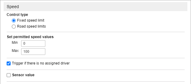

Speed
To configure a notification about speed violations, select the control type: fixed speed limit or road speed limits. For the Fixed speed limit type, specify the range of the allowed speed. For the Road speed limits type, specify the allowed speeding.
If the Trigger if there is no assigned driver option is enabled, the notification triggers when the conditions indicated for the control type are met and no driver is assigned to the unit.
A sensor value can be another condition of notification triggering. Configuring this option is similar to the notification of the same name.

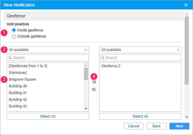

Below are the steps to configure a notification of the Geofence type.
Select when the notification should be triggered:
- when the unit enters the geofence (Inside geofence);
- when the unit leaves the geofence (Outside geofence).
Select the resource whose geofences should be displayed in the list (select All available to view the geofences of all available resources).
In the left list, select the geofences or groups of geofences (displayed in square brackets) for which the notification should be triggered. You can use the dynamic filter above the list to search.
Using the icon
, move the items from the left list to the right one.

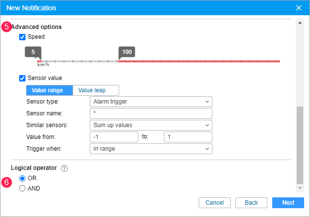

In the Advanced options section, if necessary, specify the additional conditions under which the notification should be triggered. It can be the range of speed values (the Speed option), and/or the range or the difference of the selected sensor values (the Sensor value option).
Select the logical operator on the basis of which the notification should be triggered if several geofences are selected. The OR and AND operators are available.

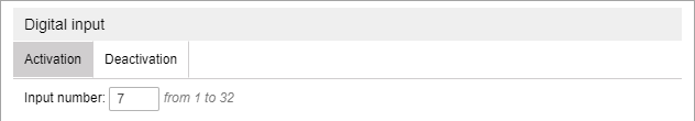

Digital input
Specify the number of digital input and the control type: trigger in case of its activation or deactivation. If the message does not have the I/O parameter, the io_n parameter is analysed.

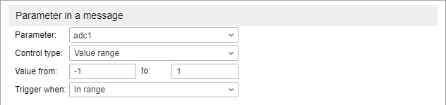

Parameter in a message
This type of notification helps to trace the parameters in the messages. The controlled parameter must be real, that is, sent by the equipment. Virtual parameters, such as speed, alt, sats, etc. cannot be controlled by this type of notification.
Four control types are provided: value range, text mask, parameter availability, and parameter lack. Only real parameters, i.e. sent by the device itself can be considered whereas virtual parameters such as speed, altitude, sats (satellites) etc. cannot be controlled by this type of notification.
To control Value range, specify the parameter name, define the minimum and maximum values for it, and select whether to trigger in the specified range or out of it. If you need to get notifications for all parameters except 0, select a value range from 0 to 0 and select the trigger type Out of specified range.
To control text, enter the parameter name and Text mask using wildcard symbols (? and *).
For such types of control as the Parameter availability and Parameter lack, it is sufficient to indicate the parameter name. For the notification to work for the parameter appearance and disappearance, on the last page of the dialog select the Generate notification only when state changed option.
For the in and out parameters, it is possible to control only the parameter availability/lack.

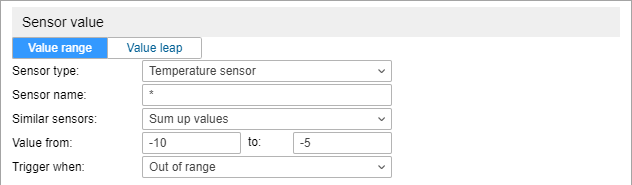

Sensor value
With this type of notification, you can control either the sensor getting some undesirable value (Value range) or an abrupt significant change in the sensor value (Value leap). To specify the sensors which should be controlled by the notification, select the sensor type in the dropdown list or set the name mask using wildcard symbols (* and ?). Both methods can be used simultaneously. If several sensors that meet these conditions (same type or name mask, or both) are found, their values can be summed or calculated individually — select the corresponding option. Then enter the minimum and maximum values and select the control type: trigger in the specified range or out of it.
If you control the value leap, enter a delta. The notification triggers when the delta is exceeded. Note that the indicated delta is compared to the module of the delta of values.

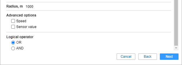

Interposition of units
This notification allows you to control the interposition of units: their approaching and moving away from each other. Select the criterion (approaching or moving away) and transfer from the left list to the right one the units whose approaching or moving away should trigger the notification. You can use the dynamic filter above the list to search.
Specify the settings described below.
Setting | Description |
Radius, m | The distance between the units with decreasing or increasing of which the notification should be triggered. |
Advanced options | Filters for speed and sensor value. |
Logical operator | The value on the basis of which the notification is triggered. If OR is selected, the notification is triggered when the unit approaches or moves away from any of the selected units. If the logical operator AND is selected, the notification is triggered when the unit approaches or moves away simultaneously from the marked units. |
The interposition of units is checked by the system using the latest messages only.

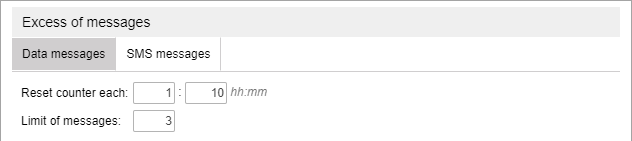

Excess of messages
With this type of notification, you can be warned if a unit exceeds the limit of messages you have set. This can be either ordinary data messages or only SMS messages. Indicate the limit of messages and set the reset interval. For example, if you configure a notification, as shown in the example below, the notification will trigger if the unit sends 3 or more SMS messages within 1 hour 10 minutes.

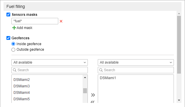

Fuel filling
This notification type allows you to control fuel fillings. When creating the notification, you can specify the sensor masks that should be used to estimate fuel fillings and their volume. Also, using the Inside geofence and Outside geofence options, you can monitor fuel fillings in regards to specific geofences (must be created in advance). Select the resource whose geofences should be shown in the list (select All available to view the geofences of all available resources). Also, choose the geofences or groups of geofences (shown in the square brackets), for which this notification should work. For the search convenience, you can use the dynamic filters above the lists.
The notification is triggered after a fuel filling is detected. To receive the notification only once, it is necessary to activate the Ignore recalculated data option.
Notification is triggered for each fuel level sensor individually.

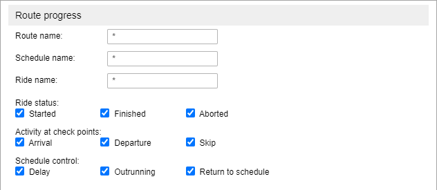

Route progress
For this type of notification, select the statuses to control: ride start, ride finish, arrival to check point, check point skip, departure from check point, etc. Additionally, you can specify a name mask for a route, schedule and/or ride.
