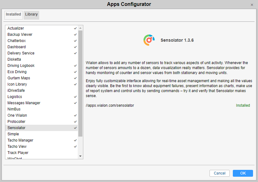

Library
On the Library tab, you can select a suitable application and add it with a single mouse click. Adding application from the library is a little bit easier as all the mandatory parameters and the advanced URL parameters are indicated by default.
The list of applications is on the left. To the right of the list is a field that displays the current information for the application selected in the list. This information includes the following: application icon, its name, short description, URL, and release date. To add an application from the library, you must select it from the list. Then, if this application is not already installed, the Add button is activated below the description. To complete the procedure click Apply and then OK.
