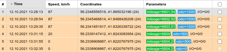

Messages with the following parameters are received from the unit:
Create a Mileage sensor based on the mileage parameter, as it constantly increases while moving and does not drop to zero during a stop.
Create a Relative odometer based on the odo parameter, as it has different values while moving and drops to zero during a stop. However, its value seems too high, so try using the odo/const1000 formula.

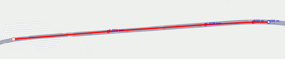

Measure the unit mileage between several pairs of messages using the Distance tool by placing the measured segments on top of the track.

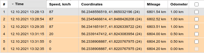

Compare the obtained results:
Mileage sensor Difference with the previous value by the mileage sensor Relative odometer The Distance tool
1 6801.54 km 1.00 km
2 6802.52 km 6802.52 - 6801.54 = 0.98 km 1.00 km 1.000 km
3 6803.51 km 6803.51 - 6802.52 = 0.99 km 1.00 km 1.020 km
4 6804.00 km 6804.00 - 6803.51 = 0.49 km 0.50 km 0.500 km
5 6804.20 km 6804.20 - 6804.00 = 0.20 km 0.50 km 0.160 km
6 6804.20 km 6804.20 - 6804.20 = 0.00 km 0.00 km -
The values are approximately equal, therefore, we can assume that the parameters for both sensors are selected correctly.

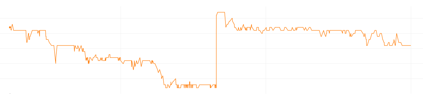

In contrast to fuel consumption sensors, the parameter from FLS may behave not the way described above, because fuel drain may happen during a stop or movement, the unit may move at an angle, the temperature may change significantly during the day, fuel may contain impurities, etc. Find more information about fuel control issues and their solutions in the Expert articlesFuel section.
Below is an example of the FLS parameter changing chart, which covers the trip and filling intervals.
In some cases, the FLS parameter behaves in the opposite way: when the engine is running, its value increases, and when filling, it decreases. This difference will be neutralized after the tank is calibrated and its results are entered into the Calculation table.
