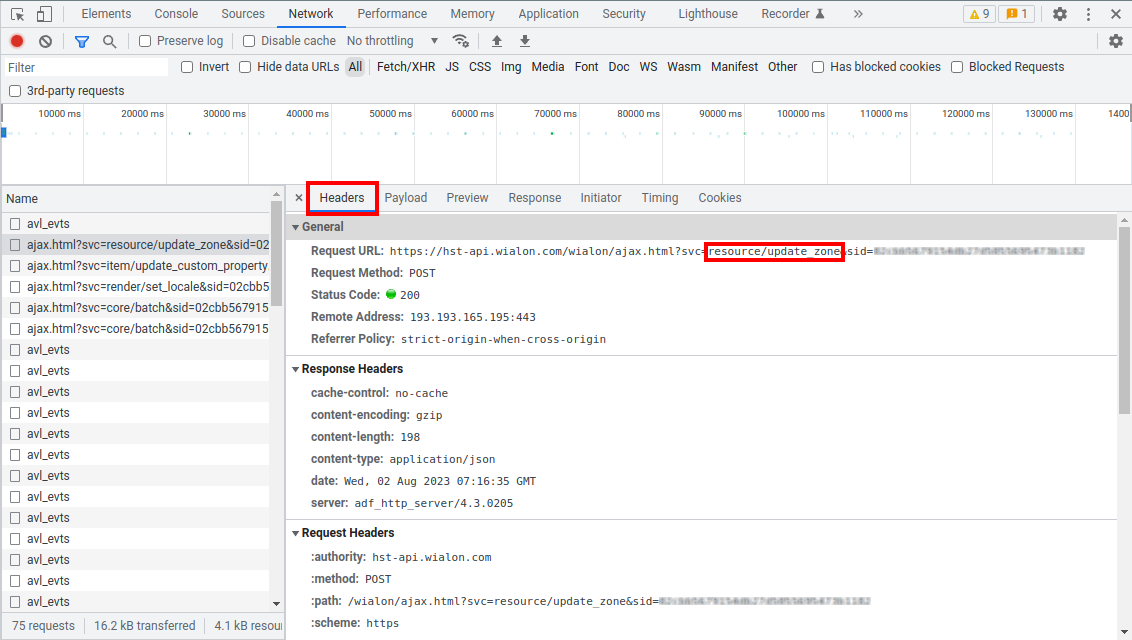

Viewing requests in the browser
When starting to explore the SDK, it is often necessary to understand which API request is being sent to the server when performing a certain action in the Wialon interface. This can be easily tracked using built-in browser tools for network request monitoring.
In Chrome browser, you can do it using the Network tab in the Developer Tools, which can be opened by pressing F12. In other browsers, this tool may open differently, as described in the browser’s documentation.
When viewing network requests, you can see the sent request, its parameters, and the response from the API server in JSON format.
Example

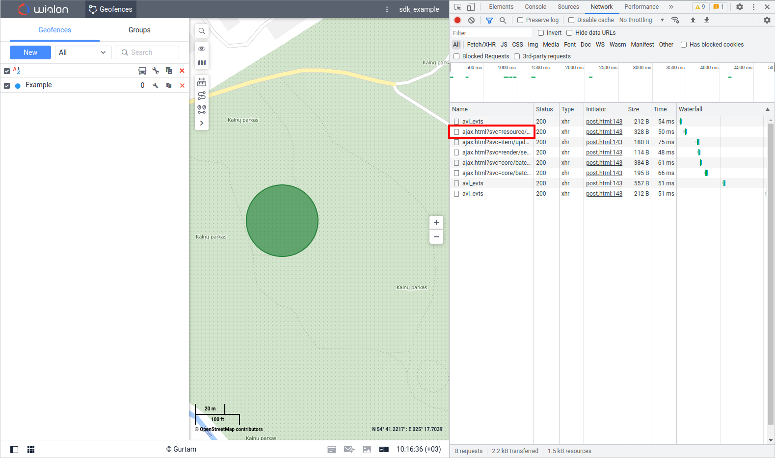

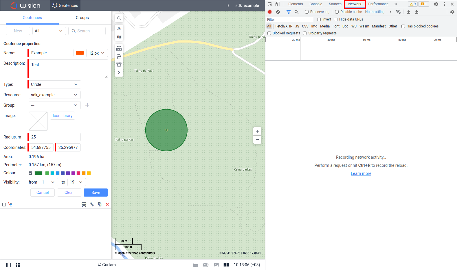

As an example, let’s create a circle geofence. Open the Network tab and fill in the Name, Description, Type, Radius, and Coordinates fields.
After clicking the Save button, the geofence will be created and the corresponding request will immediately appear in the right panel. To get information about the request, click on it.
This panel has three convenient tabs:
  • Headers — this tab allows you to see the full URL of the request, the method used for sending (POST or GET), the status of the request execution, and other useful information.
    Among other things, you can find the name of the API request. In this case, it is resource/update_zone.

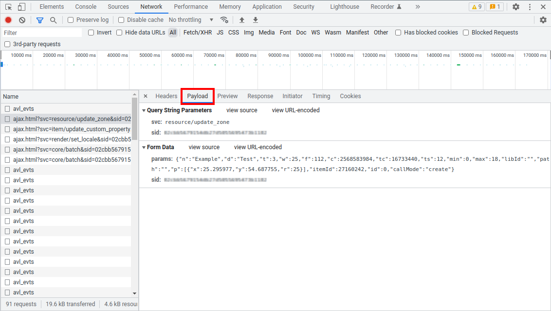

  • Payload — this tab displays the request parameters, you can read about each of them in the documentation.
    For example, the parameters that were filled when creating a geofence: where n — name, d — description, t — type (circle), w — circle radius, x and y — coordinates of the center.

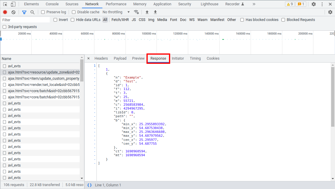

  • Response — this tab displays the response from the API server in JSON format (or its code in case of an error).
Not all functionality of the monitoring interface is based on Wialon API (an example of an exception is the Distance tool).

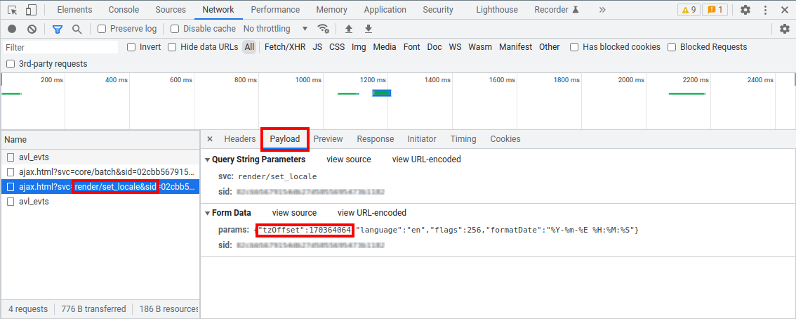

You can also find out the required value of the tzOffset parameter by viewing network requests while changing the user’s time zone in the web interface.

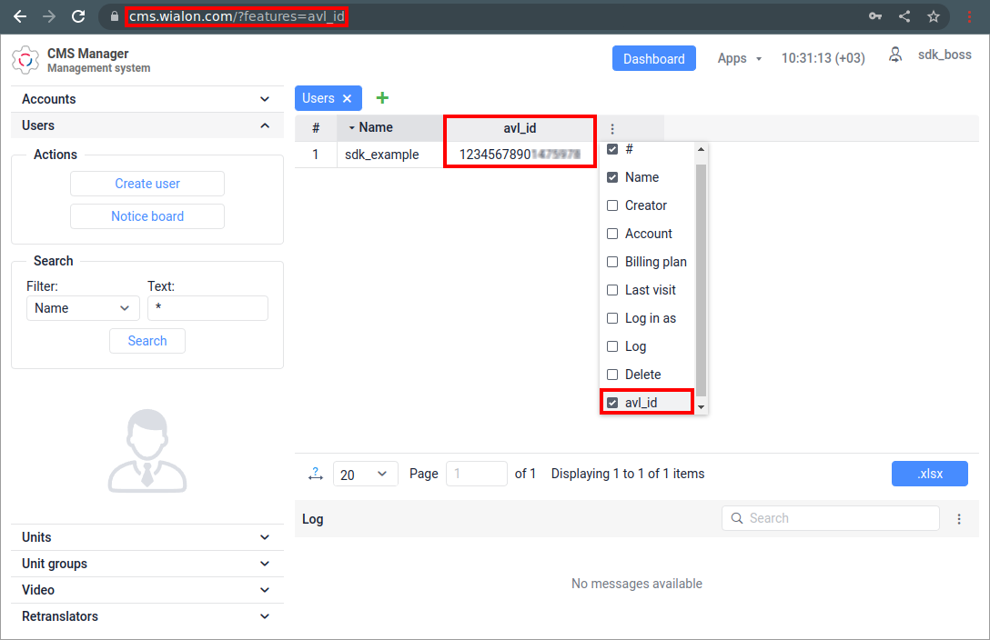

  3. In the avl_id column in the management system.
    To make the avl_id column shown, you need to log in to the CMS and add ?features=avl_id to the end of the link. An example of such a link is shown in the image below.
